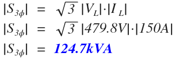

Let’s use the formula to solve for the correct magnitude of three phase complex power:
“A three phase wye connected load draws a current of 150A<-25° Amps with an applied line to neutral voltage of 277 volts. Find the total apparent power”
The apparent power (magnitude only) is equal to 124.7kVA.
That’s it. No angle.
(note that I did convert the phase voltage magnitude given in the problem to line voltage magnitude first using √3(277V)=479.8V)

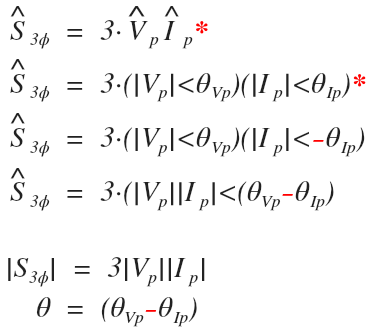

Let’s take a look at the correct formula again and break down each specific notation piece by piece and see why each one is important:
First off the lack of magnitude brackets and the included “vector hat” let us know we are solving for complex power. This means our answer will have both magnitude and angle.
This tells us the answer will be in the form of a complex value either in polar or rectangular form, not just the magnitude:
Next, the ” vector hats” above both V and I also tell us we are using the complex values of both voltage and current, and the phase subscript (p) tells us that if we want to get the correct answer, we need to use the phase values for both voltage and current:
And last, the conjugate symbol (*) after the phase current Ip tells us that the polarity of the phase current angle must be changed so that it gets subtracted from the voltage phase angle instead of adding to it.
In other words, if the phase current has a positive angle, you must change it to negative; and if it has a negative angle, you must change it to positive.

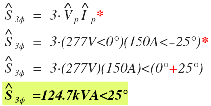

Let’s look at how the conjugate is applied, and then we will solve the example question for the correct answer by using this formula.
Pay attention to the conjugate in red:
Notice how even though we just solved for three phase apparent power, the angle is the difference of the single phase values and NOT the three phase values.
This is why the magnitude and the phase angle were incorrect in the first example.
Had enough yet?
Let’s wrap this up and solve the original question using the formulas correctly:
“A three phase wye connected load draws a current of 150A<-25° Amps with an applied line to neutral voltage of 277 volts. Find the total complex power”
Pay attention to the correct use of the conjugate in red and how it changes the polarity of the current angle:

In textbooks, you can often find the following formula for three-phase apparent power:
S=sqrt(3)·U·I*
(all variables are vectors, although I’m unable to write them as such in this simple text editor)
This should be the same as
S=3·Up·I*
…but they are not. The line-to-line voltage U has different angle than the phase-to-neutral voltage Up. In order to get the same results with these formulas, you have to assume that the U has the same angle as Up, although in reality the angle of U is 30 degrees larger than the angle of Up.
Why the aforementioned formula is used in textbooks if it’s “clearly” erroneus. Is there perhaps some kind of logic to this formula that I just don’t understand?
In the many power books and white papers that I have read, I’ve seen that formula used in the complex vector form only once and it was accompanied with a lagging 30-degree phase shift to account for using the complex line voltage in order to still get the correct power angle.
Typically, that formula is used as the three-phase apparent power formula with magnitudes only as discussed in this article in which case the power angle is typically derived from the power factor which is usually given.
If you have specific examples in books or white papers where you have seen that formula used in complex vector form I’d be happy to take a look.
The NCEES PE Hanbook has the formula S = 3*Vp*Ip = Root(3)*V-L*I-L(Cosϴp – jSinϴp)
I am confused why they use they use the phase angle difference between the phase voltage and phase current when using line quantities.
Hi Robert,
Good eye. I will agree that it is a very odd way to represent three-phase complex power in rectangular form.
I’m not sure which book NCEES® borrowed this particular version of the formula when putting together the Reference Handbook, but I would not use it.
Essentially, this version of the formula separates the magnitude of complex power (√3·V_L·I_L) from the real and imaginary components (Cosϴp, and jSinϴpp).
To avoid confusion and making mistakes, I strongly recommend using the complex power formulas we teach during our live class semester that can also be found in the boot camps.
